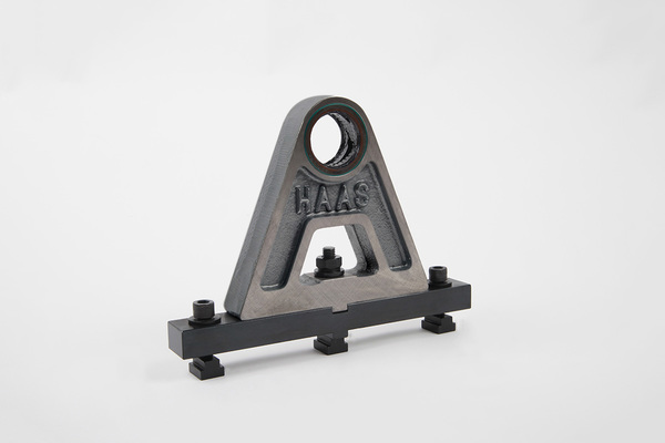

A-Frame Support, Needle Bearing, 7" (178 mm) Center Height
A-Frame support for use with HRT210M and custom fixtures.  The A-Frame Support with needle bearing and 7" (178 mm) center height is for use supporting custom fixtures held on HRT210M model rotary products. The needle bearing has a 50mm (1.9685") inside diameter and is designed to support heavy fixtures with high rotational duty cycles. The A-Frame riser block can easily be removed to use the A-frame at a 6" (152 mm) center height, making it compatible with HRT-210 Series..
FEATURES
• Easy installation and maintenance
• Supports custom fixtures
• Provides extra support for heavy fixturing or aggressive cuts
• Riser can be removed to achive 6" (152 mm) center height
• NOT for use with Haas Tooling Block Systems
