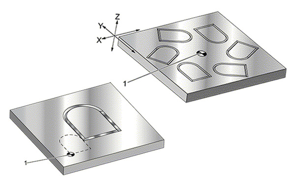

 COORDINATE ROTATION AND SCALING
Don’t repost your program for every small edit or design change; let the Coordinate Rotation and Scaling option do all the work for you. It’s perfect for working with families of parts where all you need to do is increase or decrease (scale) the size of a toolpath or pattern. Coordinate rotation allows you to rotate your part program to another location or around a circumference; it also integrates well with a spindle probe to speed workpiece setup, especially when loading cast parts or uneven components in a workholding device.
FEATURES
•  (G68) G-code commanded orientation
•  (G51) G-code commanded scaling
•  Industry standard G-code (Fanuc-compatible)
•  Program rotation and scaling executed in the background for worry free machining
•  Accuracy up to 3 decimal places when defining rotation
BENEFITS
•  Perform CAM-like functions at the control to rotate or scale a programmed path
•  Eliminates having to repost the program when working with identical families of parts
•  Ability to scale axes individually with G-code or settings
